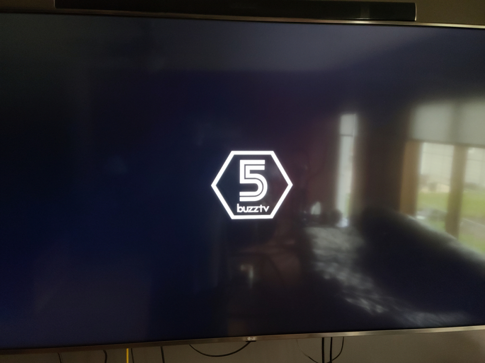

On startup gets to BuzzTv icon and flashes
Unplug and restart.
No changes.
Can't get to settings for changes.
Ideas please
remove hdmi cable from box and tv and put back in again, try different hdmi if avaible
No changes. New HDMI cable and different input.

press home button twice quick then after few seconds press home button once and let it go and see what happens
also, do you have external device connected? if yes then remove them and restart your box and see if it shows up
No changes.  Home did nothing.
Starts to load, past liquid screen then flashing icon
I guess maybe time to put in recover screen and reset. same procedure for X5
also, if this screen just started to pop now I would leave it alone fr some time if possible to see if it starts to work on its own.
because, factory reset will erase everything.
Nothing plugged in externally.
I'm fine with factory erase.
Can it be restored without access to settings?
If you have instructions I'd appreciate it
if you don't see anything beside that logo then unfortunately thats the only way what you see in the above video.
