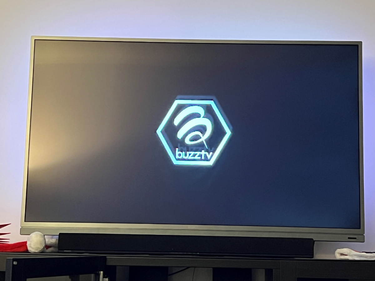

BuzzTV XRS4900 stuck during boots mode and nothing happens
Today I brought it to a local IPTV dealer to install the stream channels on mine device XRS4900. The device starts but it is stuck in the boot mode with the BuzzTV logo for several hours without any progress. It won't install all things and go to the menu.
Could someone please help me to solve the issue.

yes it apperas and i followed the factory rest and it show complete. after that I reboor the system and I saw several times the logo. But it is still stuck on the logo and it won't go to the menu.

there was no usb stick or memory card in the device. I followed you last advice and nothing happens

yes and nothing happens. it seems the device doesn't want to run. it is still stuck with buzztv logo
