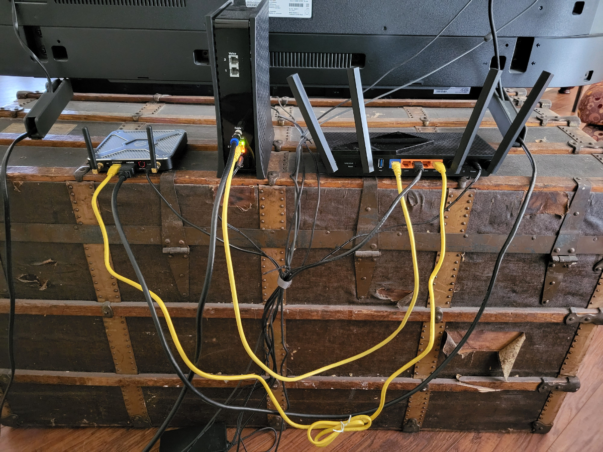

  1. I changed the VPN location. That fixed part 2 of the problem. Thank you. Part 1 of the problem. Ethernet connection is not working (but the WiFi is) - "Ethernet not connected" is still an issue. Below is the picture of the setup (not tidied up yet). Coax to Modem, Modem Ethernet to Router WAN, Router LAN4 to Buzz5.

  4. Problems: Ethernet connection is not working (but the WiFi is) - "Ethernet not connected" When VPN is on, the error message is "Cannot load portal: Failed to connect to line.protv.cc/###.###.###.# (port 80) from /###.##.#.### (port xxxxx). However, when VPN is off, the system works in WiFi mode. These problems started after moving some hardware. Everything work well (ethernet, VPN) before the change. Was Working Setup: WiFi Modem and Router (2 separate units) were connected to a MoCA box and Desktop Computer. BuzzTV5 box and TV were connected by Ethernet through MoCA box. What Changed: Eliminated the MoCA boxes. Moved the Modem and Router to be connected to the TV/BuzzTV5 box. Desktop is now on WiFi Any help on diagnosing this is appreciated.

  6. Emporium thank you so much for your response. I'm new to MoCA and your diagram (especially WAN and LAN labels) made it understandable. My original diagram was also incorrect (I did have an ethernet between MoCA and BuzzTV and HDMI to the TV). The system is working now. THANK YOU!
