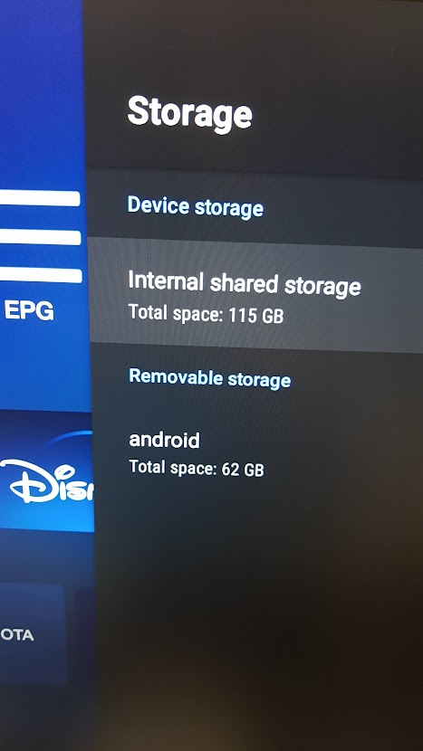

When you go to Settings -> Device Preferences -> Storage.  What do you see ?  OK, on top you have Device Storage, and it should list Internal Shared storage, and it should say "Total space: 115GB".  Then if it is done correctly, you should see Removable storage, with the name of the USB key underneath it, and then Total Space: xxGB where xx is the size of the key (similar to image I attached).
