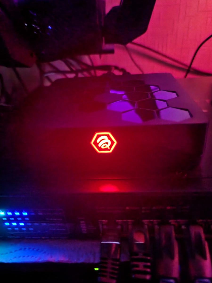

Hello dear.  Tell me I bought BuzzTv U5 left ssd 1tb everything set up everything worked, after a couple of days I turn it on and it does not respond, the red diode is on and that's it, turned off and turned on the power supply there is no reaction what's the problem?
turn you tv ON, disconnect power from the box, wait 30 seconds, reconnect power and see what happens? do you see blue light? do you see anything on the screen?
No, it did not work, the red LED in the middle is still on. I tried to pull out ssd 1tb wd red, it also did not help. (((
When you unplug the power, the RED LED goes off ?

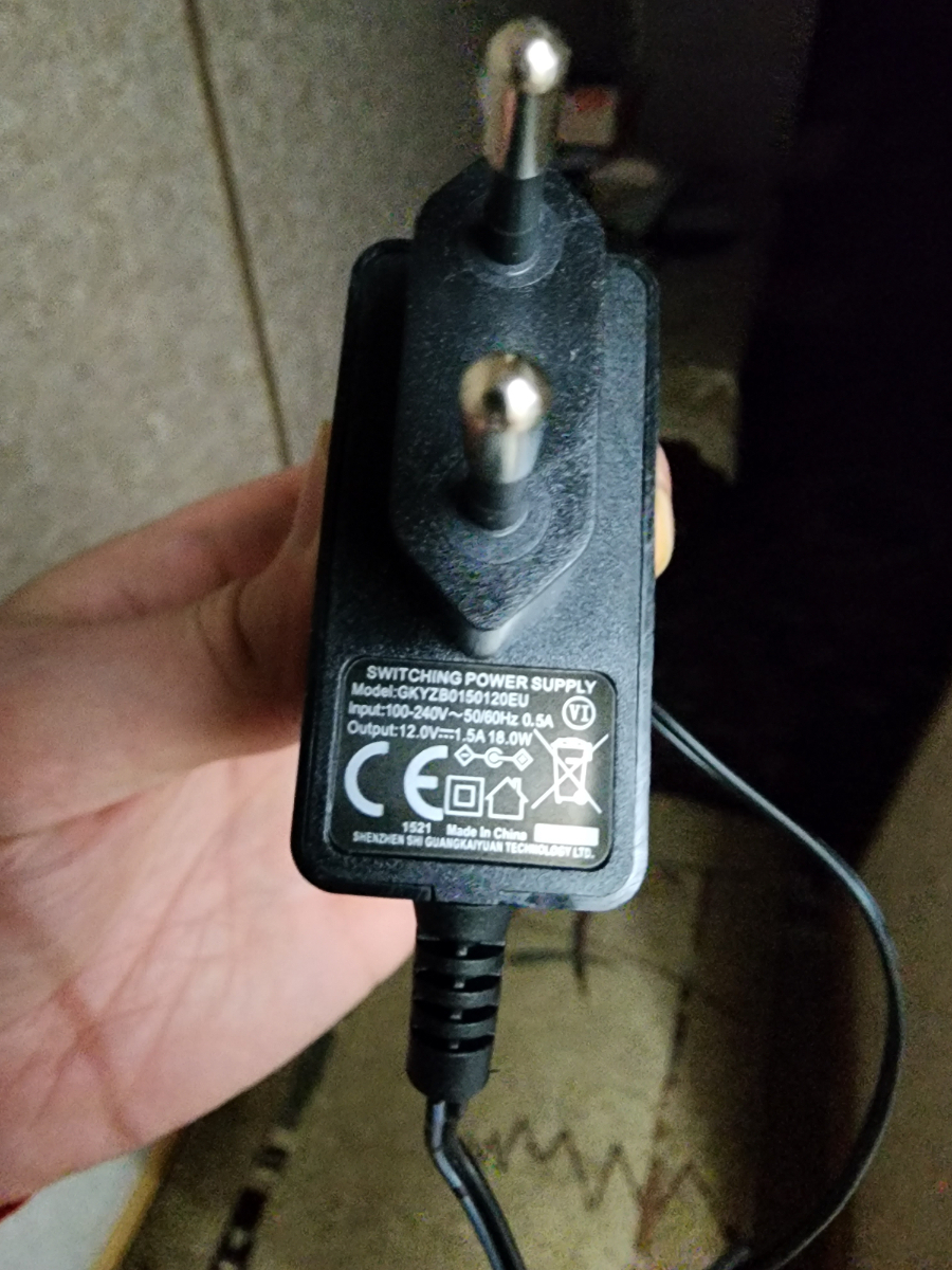

Are you using the actual Power supply that came with your U5, or a power supply from another BuzzTV box you had ?  Unlike all other BuzzTV boxes, the U5 and the xrs4900 use a 12V power supply, but all other buzztv boxes use only a 5V power supply.  If you try to use the 5V power supply with a U5, it may work (except for the 1TB HDD/SSD), but it may not be 100% stable.
Thank you for your help dear. Yes, when I turn off the power, the red diode goes out, I use the native power supply that came with the box and the native hdmi cable, now I'll try to change it to another one and unsubscribe.
In general, I tried two hdmi cables and nothing helped, everything is the same. The red diode is on. I noticed that when you connect even to another hdmi port on the TV, he sees that they connected the hdmi3 or hdmi 4 port, but there is no picture and there is a red lamp on the BuzzTv u5 set-top box (it feels like something with the power supply from the set-top box.
since its not doing anything I would say try to factory reset with tooth pick and insert into audio video hole and keep holding while powering up your box and see if anything comes up on screen. if still not then I would contact buzz team and let them take care from there. 🙂
To my great regret, this did not help, it still burns red ((it's a shame. A new box a day for her and so it happened (((

As Emporium mentions, the power cable can be the issue. Maybe it's faulty. And be sure it is indeed the correct one.
I had a related experience awhile ago. I have an X5 and a 4900 and a couple times I used the X5 cable to power up the 4900 (only because I accidently connected the wrong cable), but nothing worked and only a red light on front of device same as what you are seeing.
Then I used the 4900's correct power cable and then no more power issue.

the u5 and 4900 both use 12v power suplly
the x5 does not...it's 5v

You spending money to buy a new power supply is just  waste of money.  You already established that you are using the original U5 power supply (can you check to make sure it says 12V - in case it was accidently packaged with the wrong one).  Once tech support finishes having the tests needed run (and they need to test every possibility), they will take care of you.
I personally spend a few days with one user a few weeks ago trying all sorts of stuff because his HDD wasn't being recognized in his U5.  He had even opened a ticket with buzz.  We were convinced that the HDD was defective.  HE even orders a USB->SATA adapter cable to be able to test the HDD on his PC.   After trying everything, just randomly he mentioned that he never had a problem with his previous Buzz box, so I asked him if he was using the power supply from his old box, and low and behold that was the problem.  HE tried to quickly plug in the box, so he did not use the new cables/power supply, just reused the ones from his previous box, and that was the problem.  5V vs 12V 🙂

Yes, I flared up and I realize it, yes, I am attaching my block from U5 to 12v. But I am sure that the problem is in it I have a feeling. When I get a block, I'll check it and write it down here)
I have the North American version of the adapter, and it is also 12V 1.5A.
Maybe they got a bad batch of European adapters.  It can happen.  Anyhow, let us know what happens.

Hello dear. Send me new power supplies from U5 and X5-128. From U5 I put a red diode on the U5 prefix and the red diode is on, it's not about the block, the prefix arrived without leaving) Dear, tell me what to take Buzztv x5-128 or Buzztv U5. It's just that on U5 I like that you can put an ssd inside and a little better iron, but I'm afraid that the defective one will come again) what should I do? Which one to buy?
