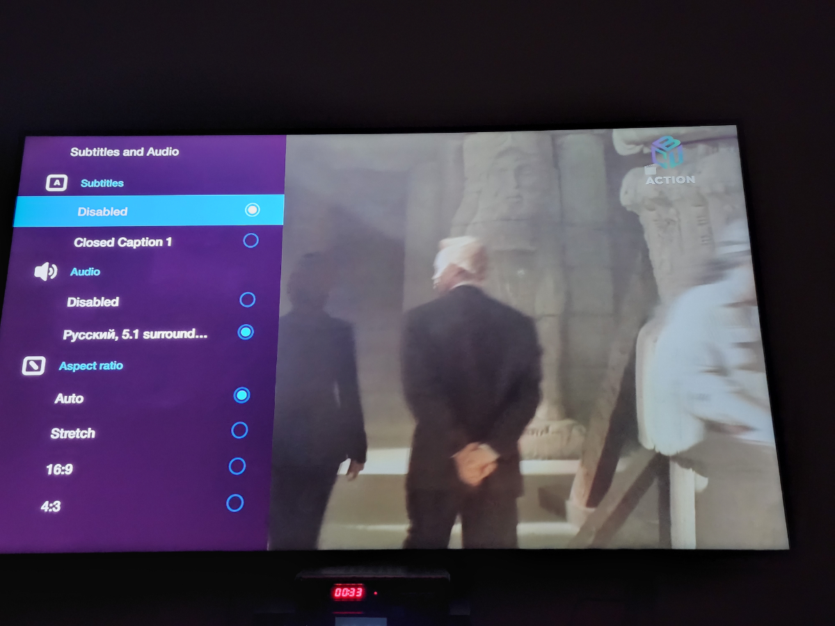

Hello, tell me why the 5.1 surround sound does not turn on. The set-top box is connected via optics to the edifier s760d, the sound track comes with 5.1 sound, but in fact it is a normal stereo. Why don't you tell me?
