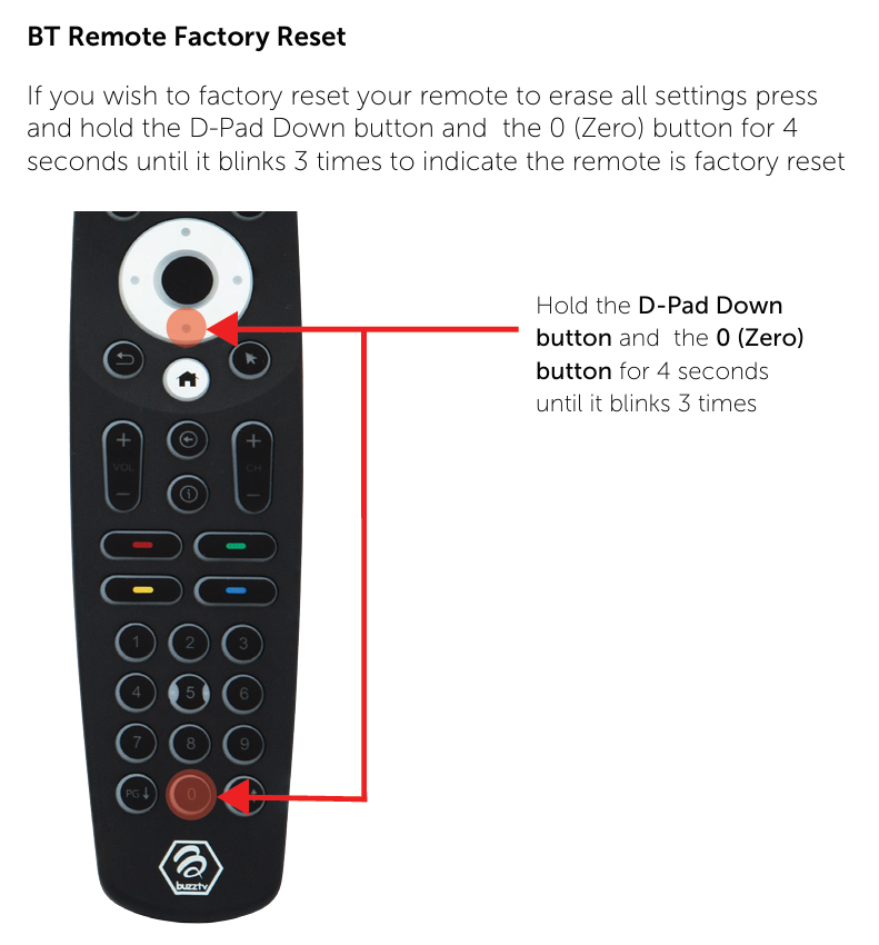

So in that case, just do a factory reset on the remote, and don't re-pair it and keep it in IR mode.
The IR receivers on the Buzz boxes are so good, that you will probably not even notice the fact that is is IR mode. It's not like those old cheap android boxes where you had to be no more than 6ft in front and dead on facing the box 🙂

I even tried different remote control and still had issue via bluetooth so thats how I found its not remote controls. its either interference or something but just on safe side I unpaired and turn off bluetooth and no issue. I never did factory reset remote but good practice as well. 🙂
