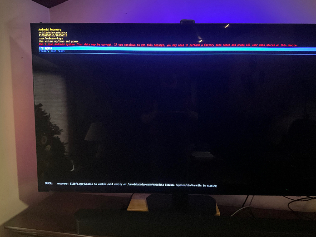

This is a PowerStation 6 with 1T ext. storage. So I’m watching tv and all of a sudden I get this screen (attached). When I click on “retry” it re-boots, shows the Home Screen for a few seconds then goes into a loop of about 4 cycles then stops at the original error screen. I didn’t want to do the factory reset until I checked here to see if anyone else is having this problem, and what fixes may be available.

Emporium, I installed the portable drive as external so I can use the internal primarily for apps and the external for recordings etc. I’ll remove it and see if that’s the problem. Thanks
I powered down and removed the stick, but the problem is still there when I booted back up. Guess a factory reset is next?
Did the reset and it’s working fine again. Is this an issue that could be corrected via an update?
Glad it is back up.  Something obviously got corrupted.  Unfortunately if it is not something we can replicate, so it is hard to "correct" the unknown.
If it happens again, I would consider temporarily leaving the nvme out of the box for a while, to see if it is potentially the source of the issue.  Not all nvme drives are created equal.
