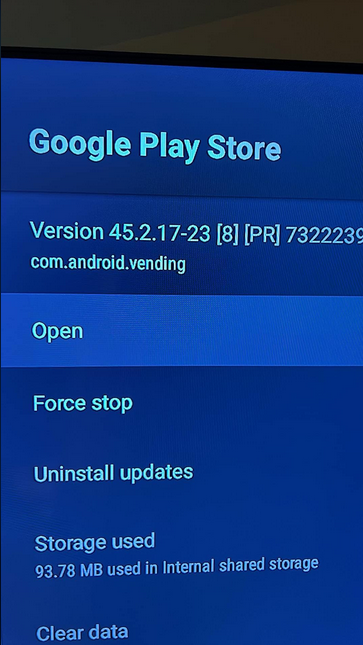

Tried to open Google Play Store app after many months of no using it.  When attempting to run the app, I just get a black screen and only pressing home button will recover.  I tried cleaning cache and data and fore stopped, restarted the X5.  No change.  Non of the search results on this topic produced any approached that fixed the problem.  Downloaded the Play Store bundle for Android 10+ and attempted to install Apk Installer which is evidently required to install their downloads.  I tried installing the APK Installer and thought it looked successful.  I didn't show as an installed app on the X5.  Clicking the Play Store downloaded file just brings up a pop-up to select an app to open -- only my browsers and Tivimate are shown as options -- not the APK Installer.
Does anyone have any other ideas how to re-install the play store apk ??  If not, I guess I'll just try alternate sources which usually will not be a frequent occasion.

Did that said not compatible go to settings and uninstall updates I did that and tried other versions and no go

how about this?
1. Clear Cache and Data:
  • Open your device's Settings.
  • Go to Apps or Apps & Notifications.
  • Find and tap on Google Play Store.
  • Tap Storage.
  • Tap Clear Cache and then Clear Data.
  • Restart your device

I had this issue about six weeks ago. I traced the problem down to the last Play Services update. If you uninstall the update login to accounts will work again. However if you have Play Store auto update on (or use Aptoid update) eventually Play Services updates itself and the login will fail again. For now I've turned off auto update, and hopefully Google will get this fixed.
