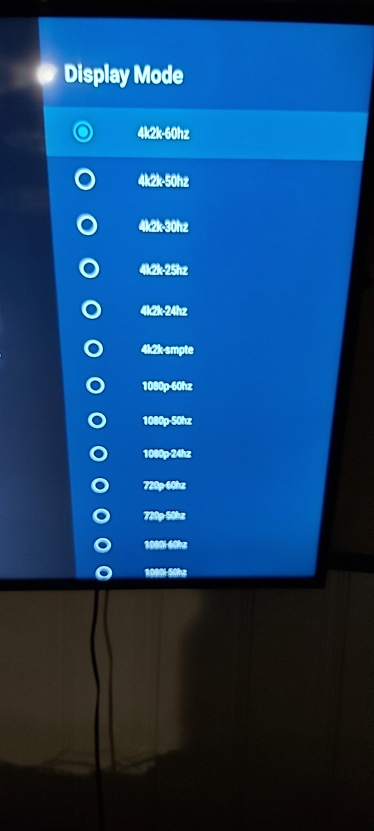

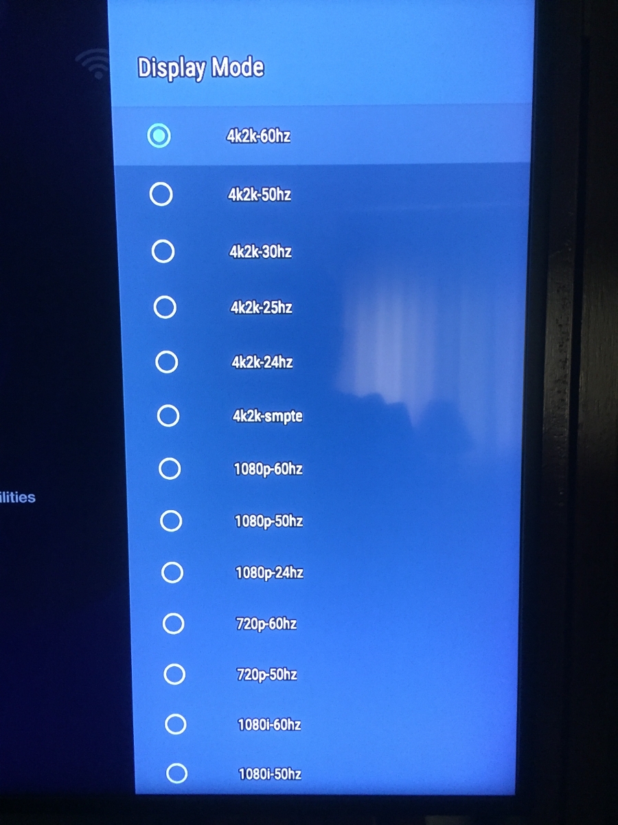

I have a XRS4500Max and a XRS4900, The 4500 has auto selectable 4K video output in the Settings, but the 4900 does not?
Just wondering why that would be?

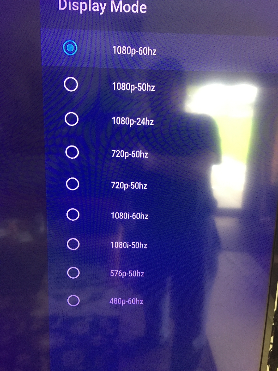

It's not even listed in the Display mode. Only goes up to 1080P 60hz
Both are in Auto Switch mode
Same internet, same cables, same channel, same provider.
4500 is in 4k, 4900 is in 1080p???

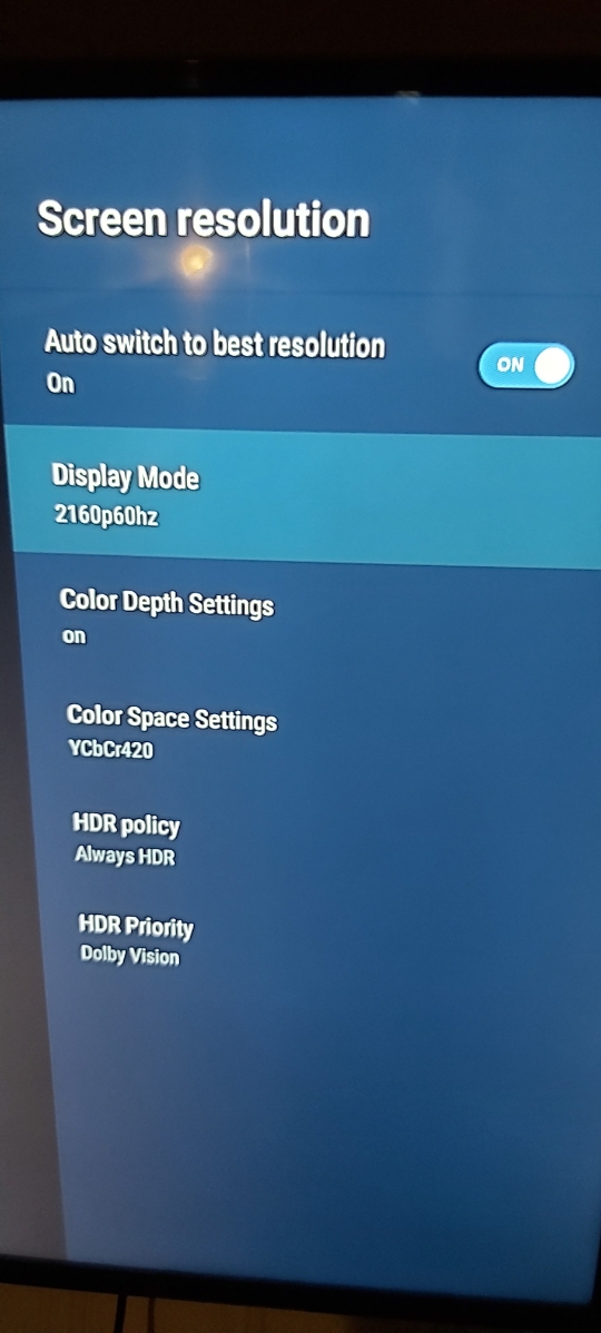

Okay, that's strange, and I do not have Color Space Setting YCbCr420 only  444 and 422???
This 4900 does not have 4K output???

Thanks NBS, checked the HDMI Multi Switch 4K x 2K 60Hz,  its good. Cables good
Damn Vizio 4K tv is not a 4K, 1920 x 1080 HD only.
