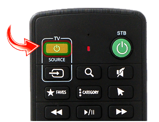

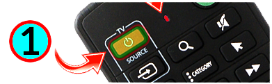

1.  Long Press [ TV Power + OK ] keys for 3 seconds
Until you see the blue light LED turns Solid Red.

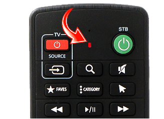

2. Press the key to be programmed. Example [ TV Power ]
The Blue LED begins to blink.

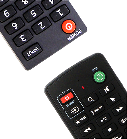

3. Aim the Remote to the front of the TV  Remote( distance less then 3CM )

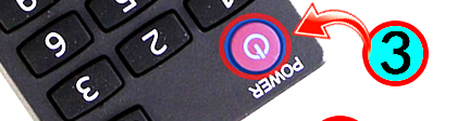

1) Press Power button on Buzztv Remote
2) Press Power button on your TV remote.
3 ) You will see that Light will blink 3 times
