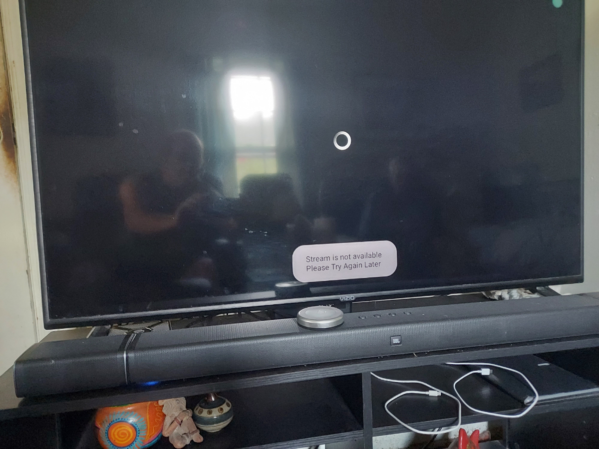

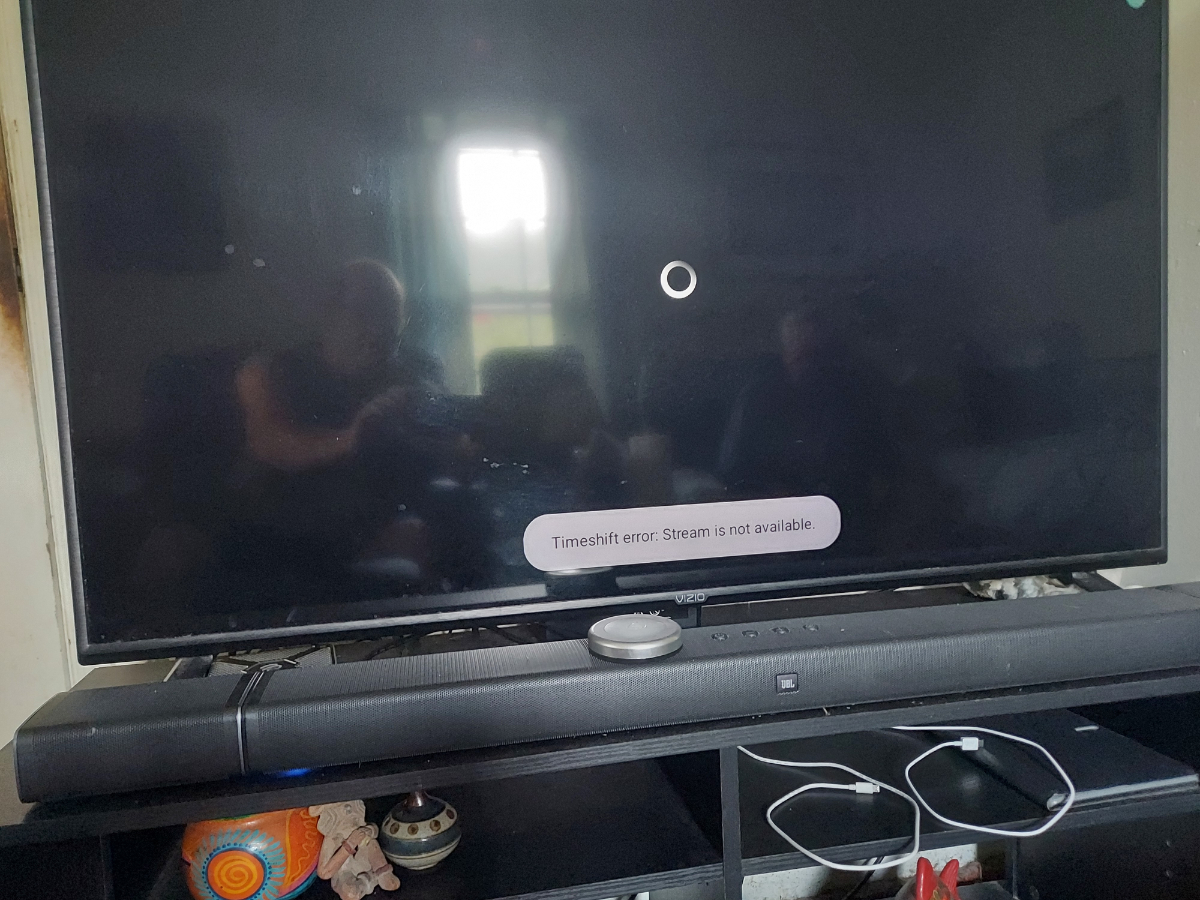

20220721_170321.thumb.jpg.ac154d08fe2a4199343082d1abae1759.jpg20220721_170324.thumb.jpg.9225423ef29f2da8e5e900972ecba00b.jpg
Edited by Flyinghigh
Double post of pic.
***UPDATE***
I do not have any external storage hooked up at the time of this pic. When I change channels, I get this error.

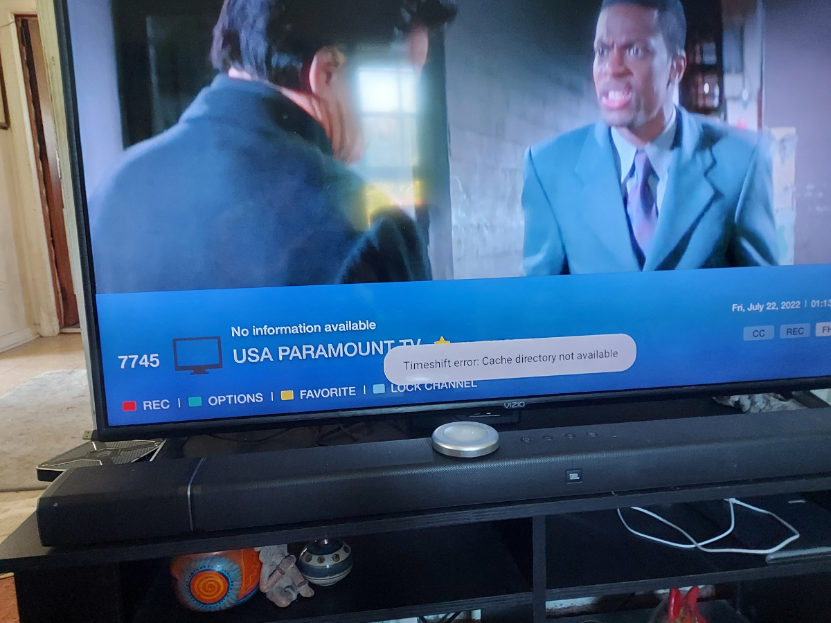

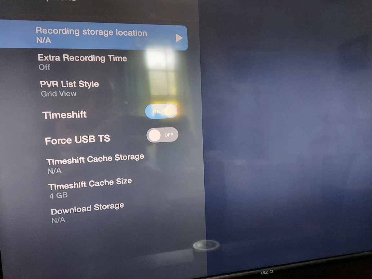

Well, I am home. The x5 will not do anything with an external drive connected. I guess a reset, it is. Before I go there. I want to use external storage with this device IF that is necessary for TS. I want to be able to pause and rewind TV. So, what steps do you suggest when I reset this device, besides following the prompts to get it going?
Yeah, I knew how to get it setup. I was asking more about when to put in a setting or change an option. I am up and running now. No external drive. I think I am going to sit tight for a bit about an external drive question. Better do some more reading.
since your box works fine without connecting external device then theres no need to reset your box. just connect that external device to your pc and format it first then connect to your box.
1. Connect your usb stick to any of USB port. (USB 3.0 works better)
2. Go to settings
3. Click storage
4. Click on your usb stick
5. You should see option erase and format as removable storage. So click on it. (If you dont see this option then format your usb first and once done dont use usb as a internal storage. Just click on move later and start from step 3 again. Now you should see erase and format as removable storage option.
6. Click format
7. Once done, now you should see usb as removable storage.
8. keep pressing back until you get to home screen
9. Now click live tv
10. While watching live TV press menu
11. Go to PVR
12. Go to PVR Options
13. Turn on Timeshift
14. Click Timeshift Cache Storage and select your USB and go back
15. Timeshift Cache Size (up to as much you want, 2 GB is good enough)
16. Download Storage select your USB
17. Now when you go to live TV and you should see TS option lid up on bottom right next to CC REC and HD info. If not press info button to see it in bottom right corner.
18. Now you should see white solid line on top of blue line indicating you can go back up to that time. You should be able to use pause and rewind function now.
19. If you dont see TS option in info bar that mean you won’t be able to rewind/pause this channel or stream
Note: TS works on secondary player only.
