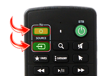

1.  Long Press [ TV Power + Source ] keys for 3 seconds
Until you see the blue light LED turns Solid Blue.

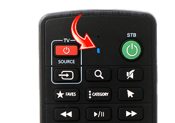

2. Press the key to be programmed. Example [ TV Power ]
The Blue LED begins to blink.

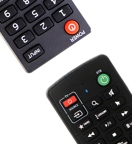

3. Aim the Remote to the front of the TV  Remote( distance less then 3CM )

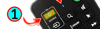

1) Press Power button on Buzztv Remote

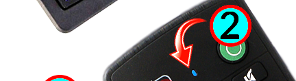

2) Press Power button on your TV remote.
3 ) You will see that Light will blink 3 times

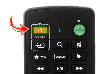

4. Press Power on Buzztv TV remote to sync the code.
Now test your Buzztv remote with your TV to make sure the power works.
